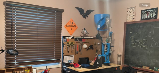

Quote from KansasGuy1961 on June 20, 2025, 1:54 pmI have a new XL750 and case feeder that worked perfectly for the first 300ish rounds. Shut everything down, cleaned out the bowl, rest of the reloader and turned all power off. Yesterday, I turned everything on to run some test rounds using heavier bullets and the case feeder won't power on. No, red/orange light which seemed normal when it was running. It just looks like it is not getting power. I checked my power feed, power cable, all looks ok and everything else is hot but the case feeder simply won't power on. ??
Uploaded files:Quote from The Human Manual on June 20, 2025, 7:34 pmTry this: unplug the unit, detach the clear plastic funnel from the front of the bowl. detach the two wires from the microswitch and jump them together. Plug it in, turn it on, see if it runs. If it runs, then the microswitch is bad. If it doesn't run, then probably the circuit board is bad.
