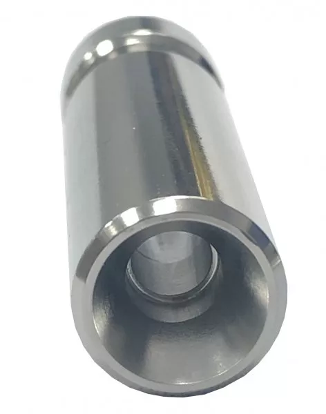

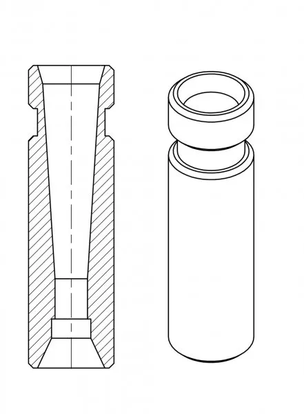

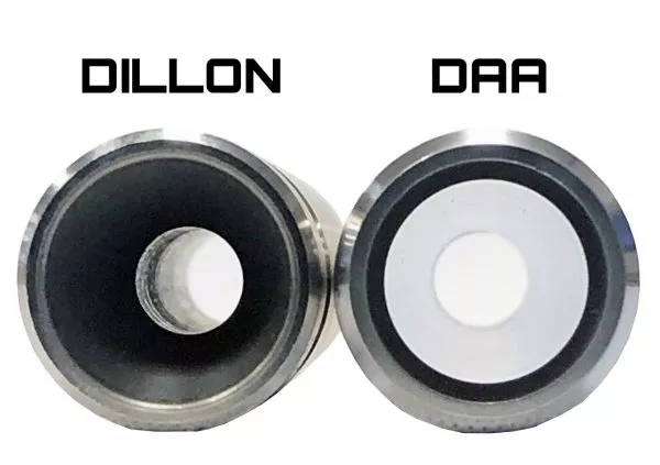

Quote from CarverSpeed on June 16, 2023, 1:45 amThe Double Alpha .223 / 5.56 powder funnel is reamed with a long taper reamer and polished both inside and out to help prevent extruded powders from bridging and sticking in the case mouth:
Quote from Matthew on June 20, 2023, 1:55 pmQuote from sinister on June 16, 2023, 1:45 amThe Double Alpha .223 / 5.56 powder funnel is reamed with a long taper reamer and polished both inside and out to help prevent extruded powders from bridging and sticking in the case mouth:
Just ordered one of these, thanks for the tip. N140 hangs up a bit in .223, so I've adopted a bit of a handle jiggle at the top of the stroke, hopefully this will smooth out the process.
Quote from ARMTGuy on June 20, 2023, 3:57 pmSlowing your handle downstroke speed so that it takes at least one full second to fully move the powder bar to the far side helps prevent powder logjams as well. By not dumping all the powder at one instant into the top of the funnel, powder has a better opportunity to slide through the funnel.
Quote from Matthew on June 30, 2023, 12:25 pmQuote from USRifleCal30 on June 20, 2023, 1:55 pmQuote from sinister on June 16, 2023, 1:45 amThe Double Alpha .223 / 5.56 powder funnel is reamed with a long taper reamer and polished both inside and out to help prevent extruded powders from bridging and sticking in the case mouth:
After loading about 1500 rounds so far with zero powder hangups, this DAA powder funnel is fantastic.
