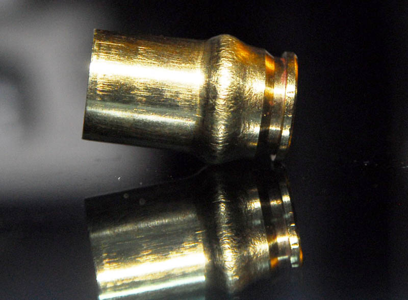

Quote from Reloader on July 17, 2012, 10:33 pmHerb,
If I am understanding you correctly it sounds as if this used brass is coming from a bad weapon. I used to have a Tec-9 which would bulge the brass... If your rounds look anything like this:
http://www.scattercreek.com/~nubus/images/9mmbrass.jpg
then I'd say your weapon is extracting the casing before 100% of the pressure has been discharged out of the barrel.
However, without more information, this is a much info as I can pass on...
Herb,
