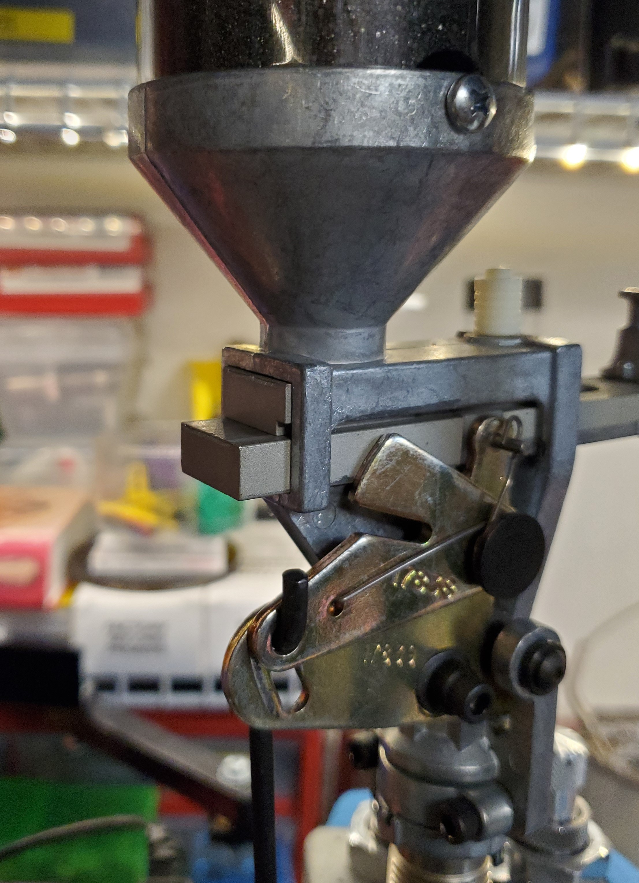

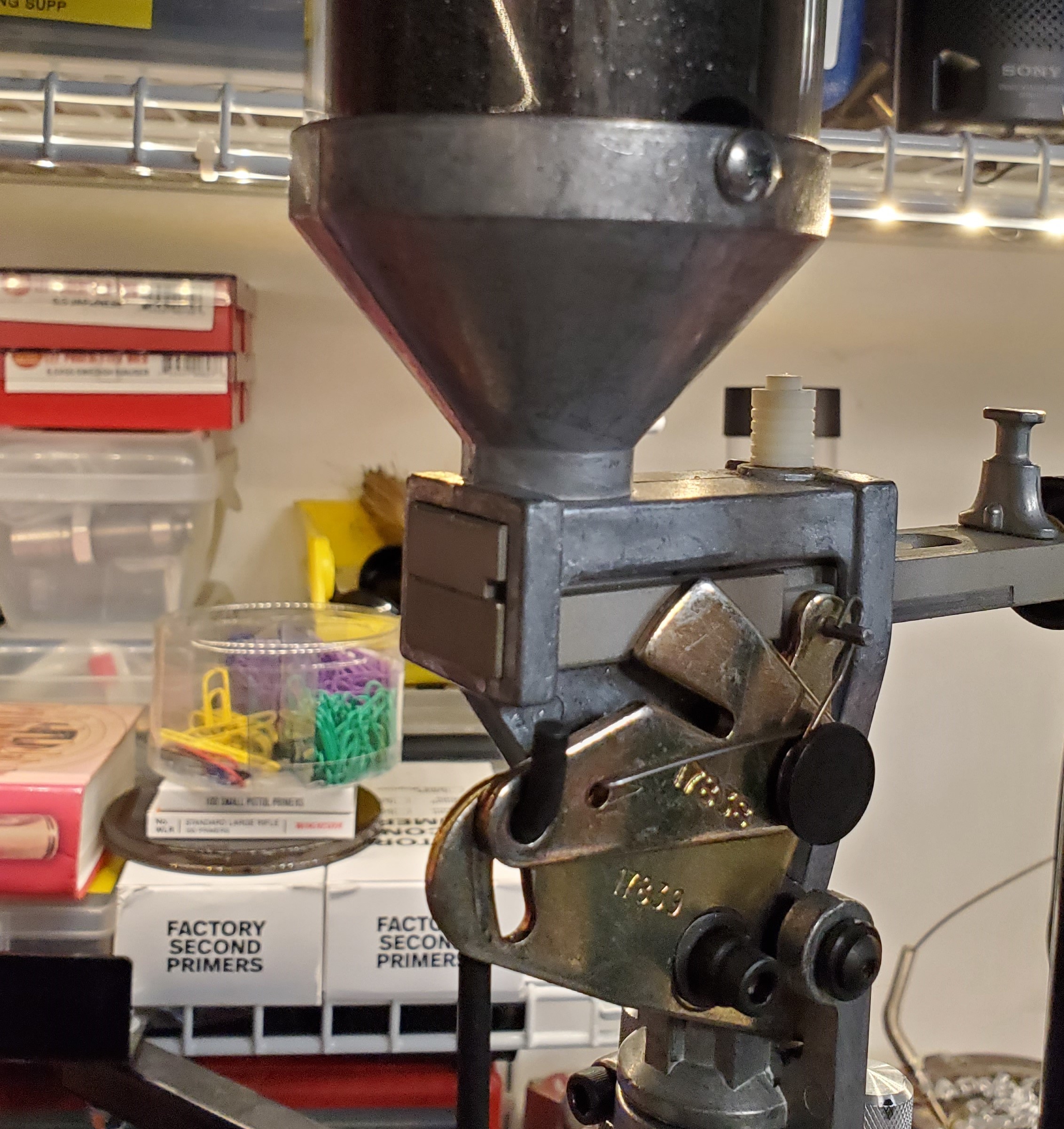

Quote from spur0701 on January 6, 2025, 2:42 pmAny ideas or pointers on what I might be doing wrong here? This is a powder drop of 5.2g of BE86 on a 115g 9mm load using already primed mixed 9mm brass from American Reloading. I'm using a 550b with the Dillion powder measure. Sometimes the powder measure does not fully actuate and no powder drops despite the case being fully inserted and the roller lever fully down....and I have to keep my eye on it and push it flush with my finger to drop the powder.

Quote from The Human Manual on January 6, 2025, 5:46 pmThe powder measure die is not threaded deep enough into the toolhead. Use a sized case to activate the measure, and adjust the die down until the case mouth is flared out at least .010" larger than a sized, unflared case mouth measures. When properly adjusted, the powder bar should go full travel before the handle bottoms out.
