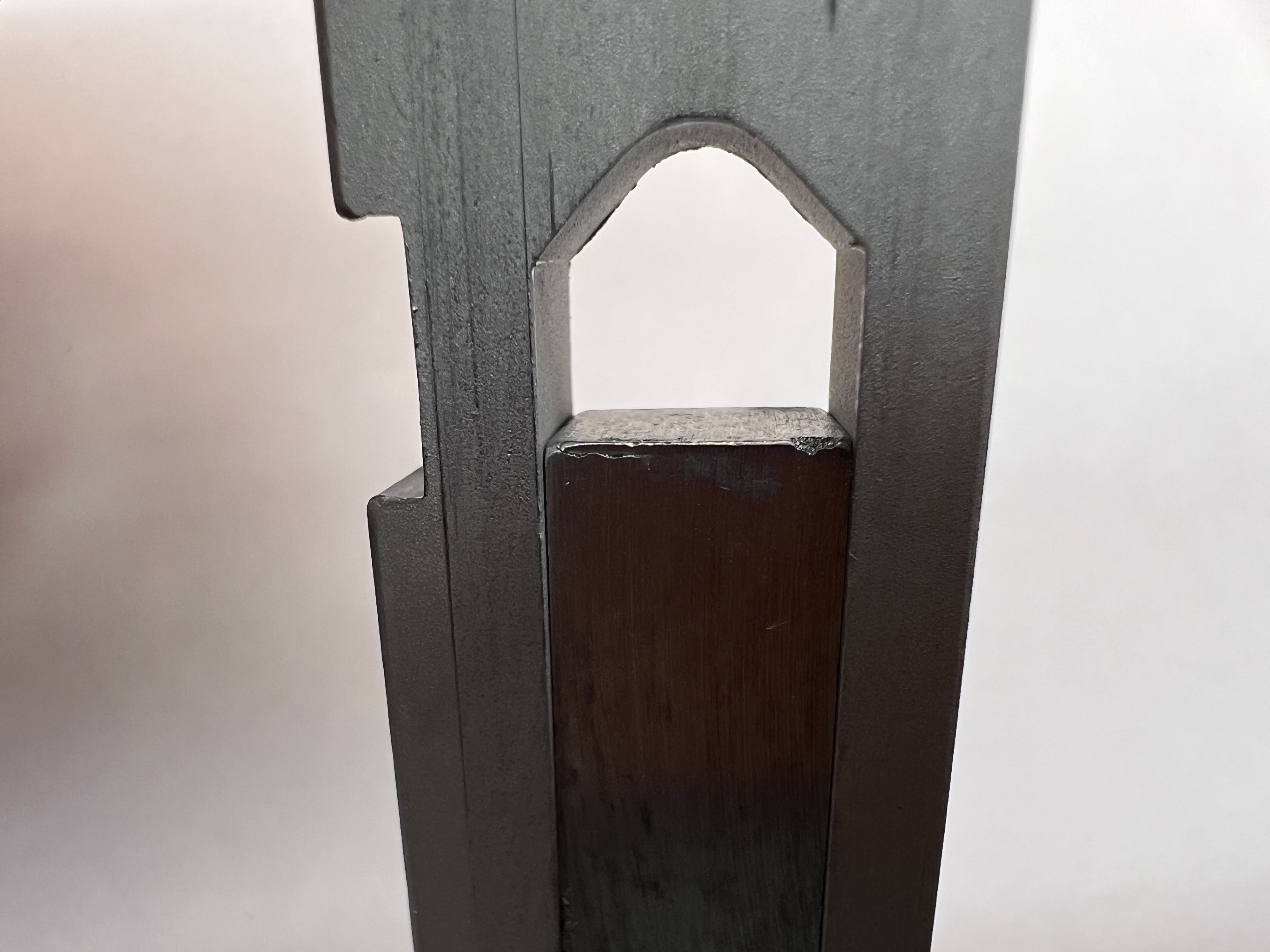

Quote from CharleyH on September 27, 2025, 8:23 pmI inspected my powder measuring assembly because I am having a little inconsistency with powder charges and I noticed a rough edge on the edge of the powder bar. See picture . My 750 is only a bout a month old so I believe it came this way. Would this be covered by warranty. Or is this considered an acceptable part?
Uploaded files:Quote from The Human Manual on September 29, 2025, 5:56 pmIt's a bit ugly. I doubt this would cause any inconsistency, but this adjustable insert should have been rejected. Please email me at gary.kieft@dillonprecision.com and I will send you a replacement insert.

Quote from CharleyH on October 9, 2025, 6:00 pmThank you for all of your help Gary. The replacement part arrived very quickly and my loads are now consistent. I suspect the problem I was having was being new to the equipment.
Thank you again!
