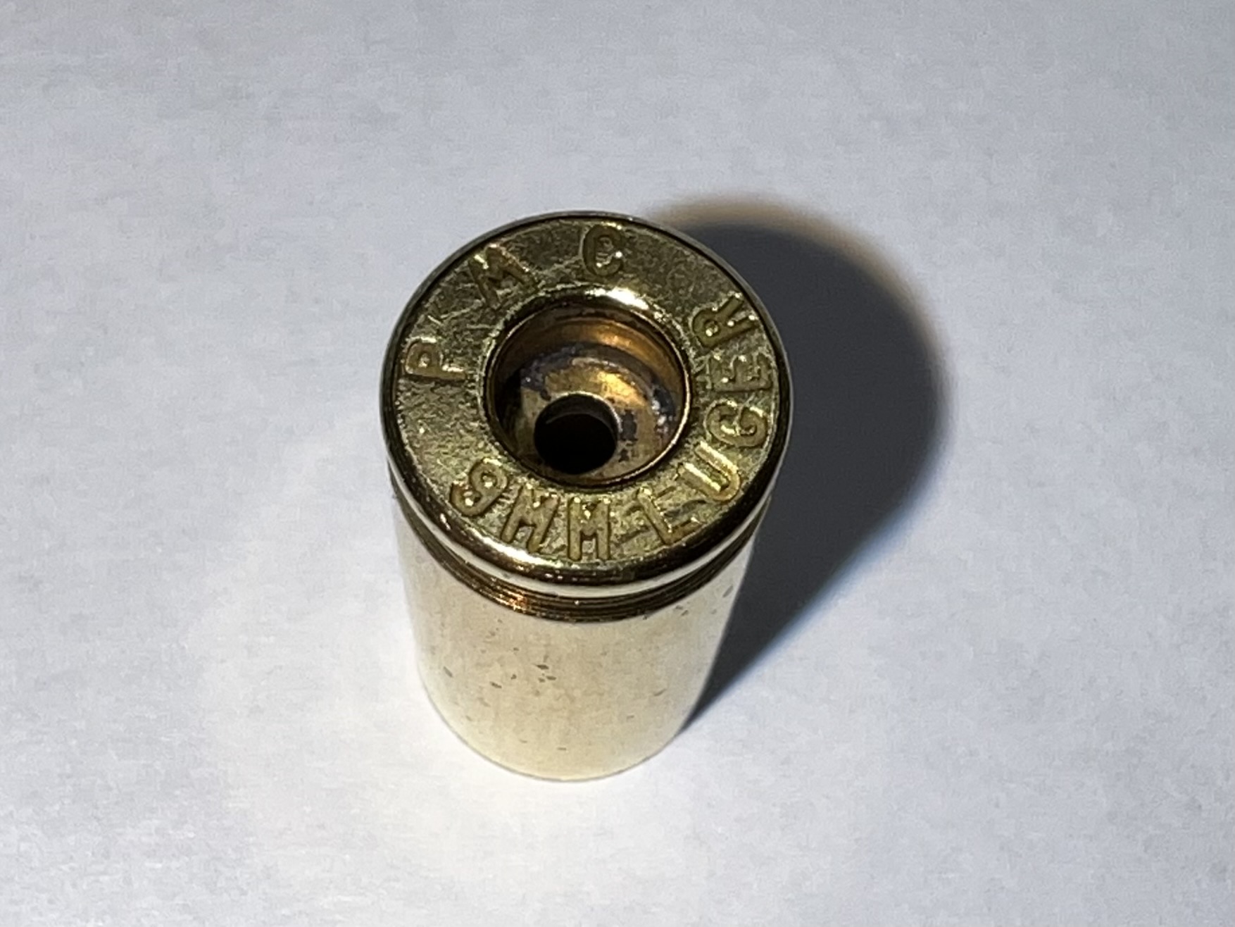

Quote from CharleyH on October 14, 2025, 3:28 amI am pretty new to reloading and am reloading 9mm on an XL 750. I have been de priming prior to wet tumbling with stainless steel rods. The shells come out very clean, but there are often minor deposits left in the primer pockets. I have been using an RCBS wire brush pocket cleaner but am wondering if this is overkill? I am doing club level action shooting, so I rarely shoot farther than 15 yards. So how clean is clean enough for the primer pockets? Here is a picture that represents how the cases come out after tumbling, sometimes there are three small dirty spots and some crud along the edge. Is it worth cleaning this out?

Quote from CJTIM on October 15, 2025, 8:18 amIn my opinion that's overkill. The level of clean they come out of the tumbler is clean enough.

Quote from The Human Manual on October 15, 2025, 3:37 pmDon't worry about cleaning primer pockets. You won't get enough buildup to prevent seating primers, and a dirty primer pocket won't negatively affect accuracy.
