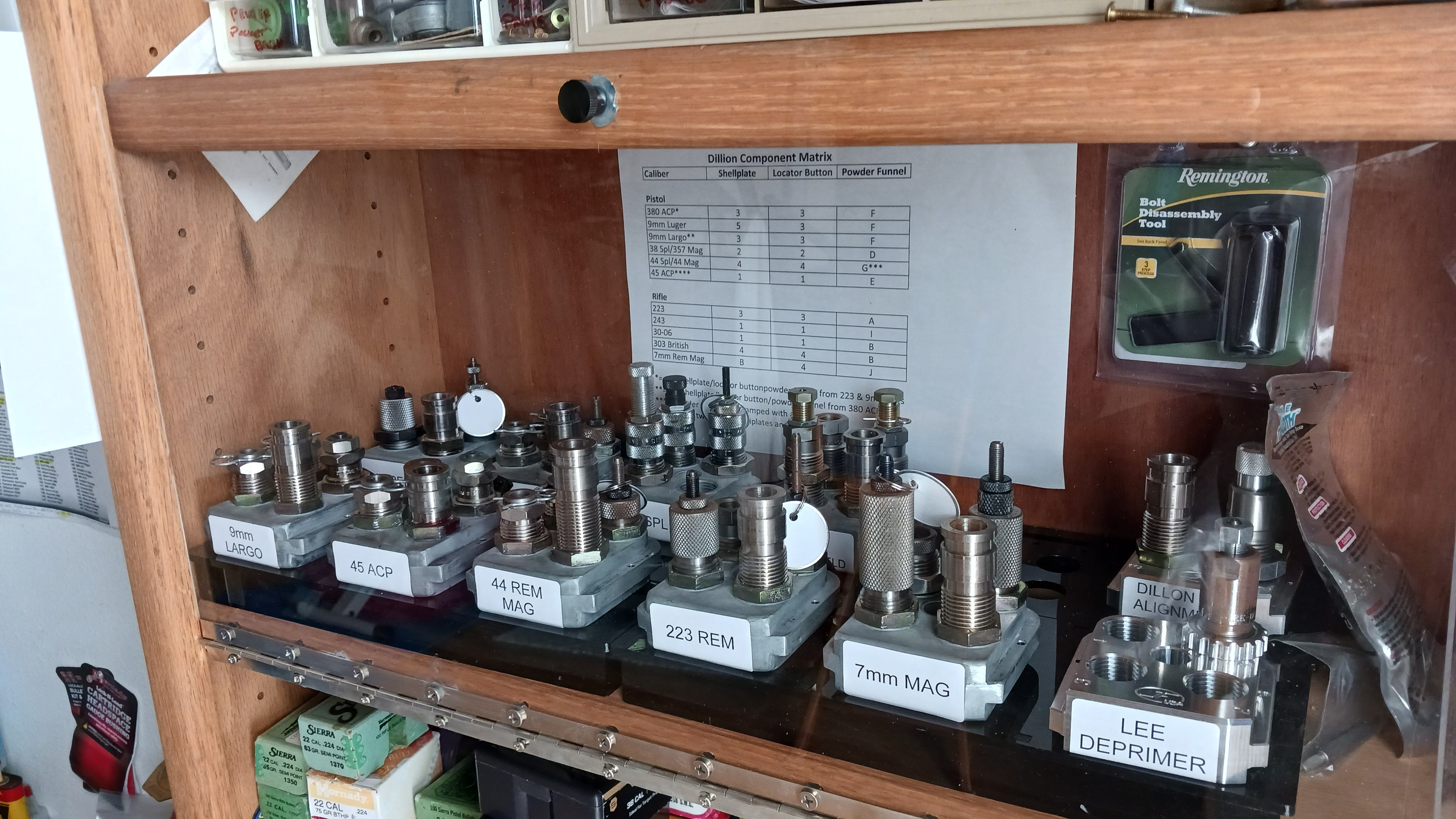

Quote from epags1 on May 7, 2024, 8:14 pmBought the plastic bottoms from eBay and added the clear plastic cover for the shelf to protect from the salt air here on the coast.
