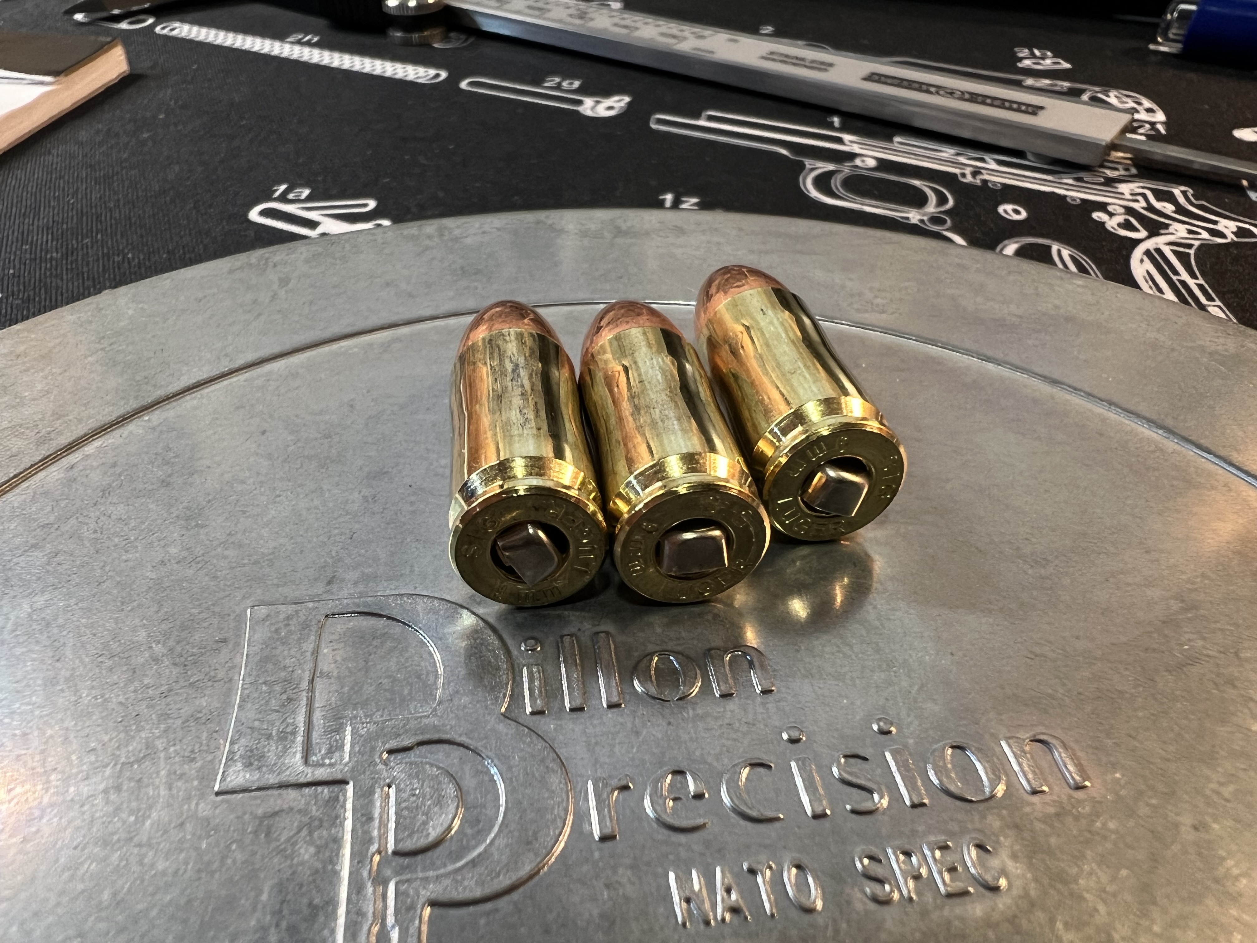

Quote from CrystalRed on August 12, 2024, 11:19 pmHas anyone seen this before?
Seems that my SDB plate sometimes hitches on station 2 catching the feeder surround on the plate and this causes either the primer to jump out of the tool and onto the floor or for the primer to be inserted crookedly. I feel nothing in the handle to indicate a problem is occurring.
I plan to deconstruct these rounds. Is it safe to use Station 1 to eject these twisted primer?

Quote from The Human Manual on August 14, 2024, 3:38 pmYour problem is the primer cup coming up through the shellplate. This has nothing to do with the depriming process.
In order to more safely deprime the sideways primers, you need to desensitize the primers using WD-40 first. Then, after you use a kinetic bullet puller to remove the bullet and powder, you can gently run these cases back through station 1 to push the primer out of the pocket.
