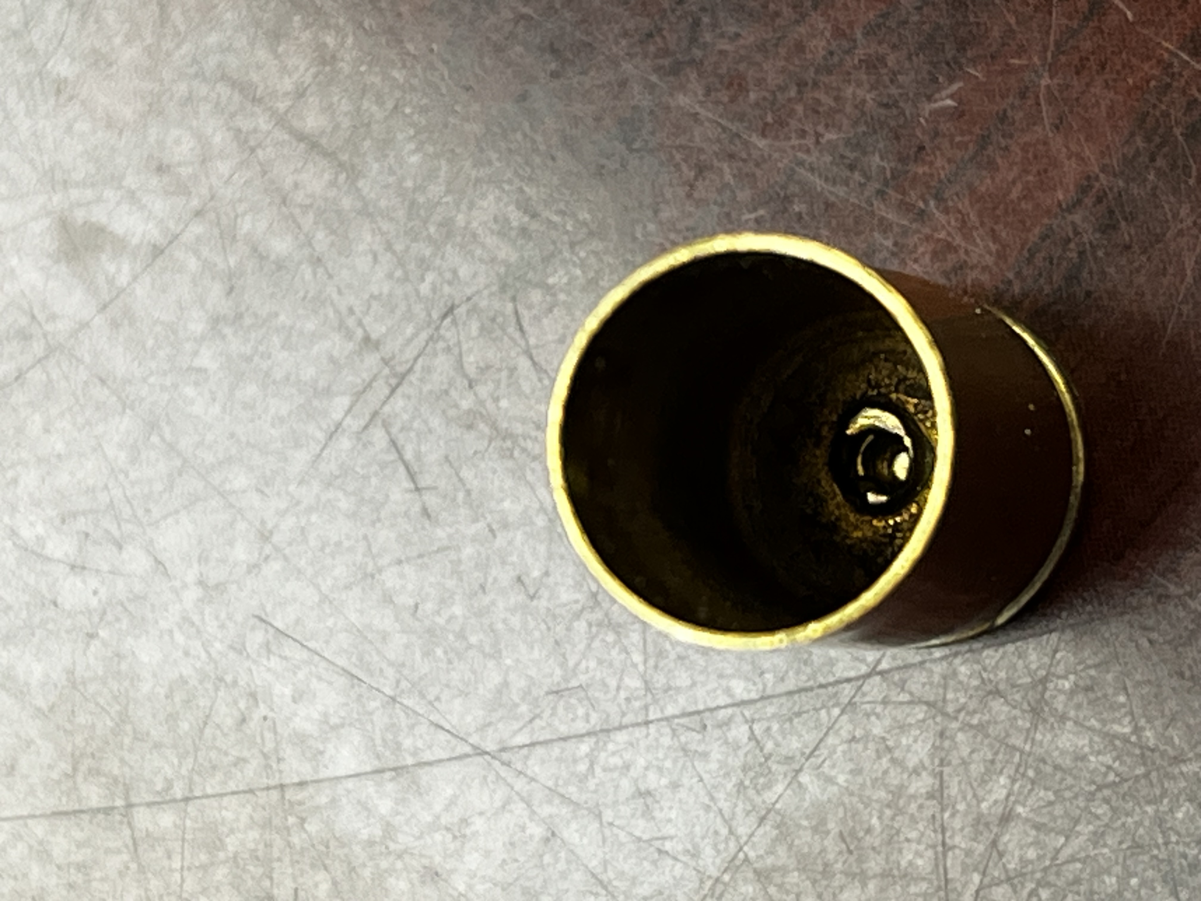

Quote from Jacek on October 22, 2025, 6:16 pmHere is the inside of the case after swage and primmer seating. Looks clean inside with no deformation.
Uploaded files:Quote from The Human Manual on October 22, 2025, 6:29 pmI can see that the burr left after the primer flash hole was punched has been flattened during depriming or swaging. Deprime a case, then use the dust cover/depth probe on calipers to measure the primer pocket depth. Then swage the case and remeasure it.
