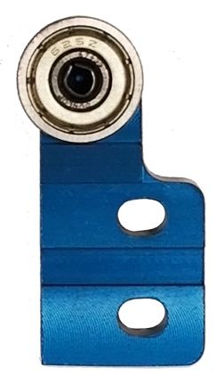

Quote from micky_dc on July 31, 2023, 5:58 pmWhile I haven't personally tried it, this looks interesting:
https://uniquetek.com/shop/ols/products/650-bearing-indexer-block
